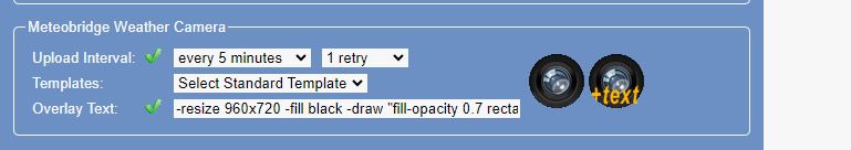

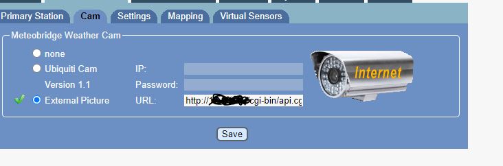

Hi guys, quick question how often does the meteobridge cam link update is it 5 minutes? Also if i were to add a link to a page on my website will it refresh on its own or do you have to manually refresh with your browser? I would like to be able to add it in a way to were it either refreshes on its own or its live. Was not to sure about this. My cam is the reolink RLC-510A.
When i enter this text in my cam section in the external picture area were it says URL: it will not load anything current.  :sad:
http://my ip adresss/cgi-bin/api.Snap&channel=0&rs=wuuPhkmUCeI9WG7C&user=admin&password=my password

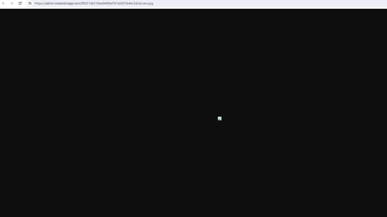

This is what i get when i click on the "cam INTERNET image" inside meteobridge. I don' understand what i am doing wrong.
When i click on the + TEXT image all i get is na old cam image before i took it down a few months back. For some reason it will not load anything current. Camera is working viewing it on my phone.

 Error: in meteobridge... Camera URL not providing data:
Trying again this morning when it opens i get this black screen or when i click on the (+text) i get an old image from when i had the cam up not the current live.

Hi Wim, thanks for your reply! this is the url i am using. What is the exact text i need to paste into the " external picture URL" section?
http://IP ADDRESS/cgi-bin/api.cgi?cmd=Snap&channel=0&rs=wuuPhkmUCeI9WG7C&useradmin&password=METEOBRIDGE PASSWORD
Yes to both in bold are correct but what about the rest?
« Last Edit: June 06, 2024, 10:53:29 AM by Adrian23 »

Tried both no luck. Really not sure i know the IP is correct and my password and user which is admin. I have been using this article which explains how to do it but not sure if i am using the format or text adding it to the meteobridge. Had this working before not sure whats the issue now. Thx for your help
https://support.reolink.com/hc/en-us/articles/360007011233-How-to-Capture-Live-JPEG-Image-of-Reolink-Cameras-via-Web-Browsers/
« Last Edit: June 06, 2024, 12:06:57 PM by Adrian23 »
