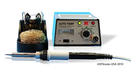

A decent temperature-controlled soldering station
For a long time, I did my soldering with cheap models I could find at Radio Shack, and while simple pencil irons will do a passable job, it's hard to beat quick-heating, variable-temperature, exchangeable-tip soldering stations--especially when you have to solder everything from tiny surface-mount components to the mounting lugs on connectors.  It still doesn't have to cost a lot - Weller is the "name brand" everyone knows, but there are others that will do an excellent job and cost less.
The above link is to the model I have, which I originally bought through All Electronics at a significant discount.  It's done a great job for me.  AE still sells replacement tips.
