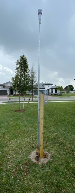

Just wanted to share my new Tempest weather station setup alone with my Cocorahs rain gauge.

Very nice. I just put up an almost identical arrangement. Will post a pic when I have a chance.   Unfortunately I am being sent my third Tempest! The first one had begun peeling the 'reflective' surface on the bottom of the wind groove within 4 DAYS of being set up and the barometer was way off and very erratic.  This current unit has the same barometer issues. I hope the third one is ok, getting very frustrated.
I made sure the elevation and height above ground were accurate. I also tried a makeshift 'calibration' after a few days by adjusting those parameters to make the barometer read correctly for my location but within a few hours it was way off again.  I also let them each do their 'adaptive learning' for several days time and there was not even a hint of the data getting better.
On the plus side, the support people at WeatherFlow have been great, looking at my data on their side to see the issue themselves and sending out new units. They pledged to help get to the bottom of the issue and if they have a bad batch of sensors, they want to know about it and make it right. So hats off to them!
Good luck with your new set up.

Wow sorry to here all your problems with the tempest. I have had 0 issues thus far with it and really like the station in particular the ultra sonic wind sensor i am loving those 3 sec wind updates for sure. I share my data to cwop,pws, etc with my meteobridge but i am looking on maybe adding a rasberry pi in the near future for templates. A bit on the complicated side for me so we will see. Hope everything works out for you
