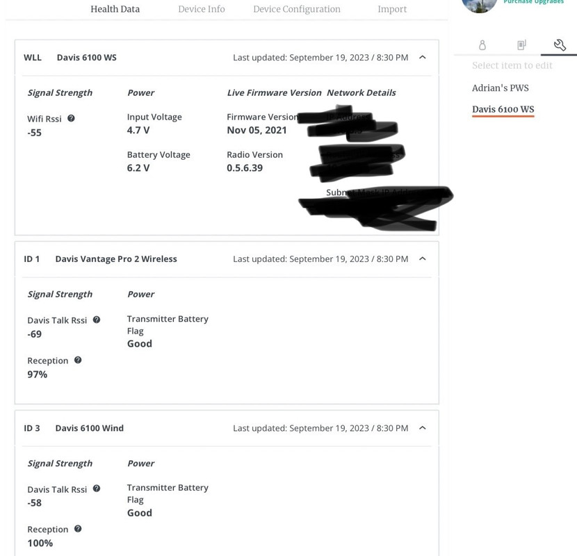

Online Adrian23
  • Posts: 354
Re: Need advice on Davis repeater before I purchase
« Reply #19 on: September 19, 2023, 08:41:23 PM »
This is under Adrian’s PWS Tab look at that RSSI..! Is my console pulling from that?
Here is the WLL 6100 which is better and rssi has been fluctuating low 60’s to mid upper 60’s.
Online Adrian23
  • Posts: 354
« Reply #20 on: September 19, 2023, 08:50:45 PM »
As you can see both tabs have different RSSI numbers how they affect each other is what I don’t understand.
« Last Edit: September 19, 2023, 08:54:54 PM by Adrian23 »
Online PaulMy
  • Posts: 5428
    • KomokaWeather
« Reply #21 on: September 19, 2023, 09:58:05 PM »
I don't have the 6313 Console but have the 6100 WLL, and as far as I understand the Console and WLL are two independent devices and each can upload to their own Weatherlink.com site.  There is no connection between the two either locally or at WL.com other than they both obtain the same data from the ISS ID-1 and Wind ID-3.  Both your Adrian's PWS (updated from Console) and Davis 6100 WS (updated from WLL) which is located a block to the north west show on the map.   From your attached screen captures the WLL device reception data is much better compared to the Console.  Are the Console and WLL devices located where they are shown on the map (quite a distance apart)? and where is the ISS and Wind sensor in relation to these two separate devices?

Online Adrian23
  • Posts: 354
« Reply #22 on: September 19, 2023, 10:08:31 PM »
Enjoy,
Paul
Hi Paul, oh the console and WLL are not far at all from each there in the same house. The WLL is my living room and my Console is in my bedroom. It’s also a 1 floor house they are not far away from each other at all. Wow now I am really confused you said they look far away on a map? If so that needs to be corrected oh geez. Why the separation? How can this be fixed?? The ISS and my second transmitter which I named “ wind”  are next to each and are literally no more then 30-40 feet from the WLL and just a bit further from my console in my bedroom which could be about 100 feet maybe a little more but it’s not to far that’s all I know. My confusion is why does the WLL have better RSSI and the ISS is bad. Is the ISS RSSI getting put into the console? Sorry for all the questions
Edit:  i tried to correct both devices locations the WLL and Console and I added my home location to both. Hopefully you can see them together now on the map
« Last Edit: September 19, 2023, 10:40:10 PM by Adrian23 »
Offline Mattk
  • Posts: 2008
« Reply #23 on: September 19, 2023, 11:00:24 PM »
From all accounts the 6313 (WeatherLink Display  :grin:) has inferior antenna hardware (hence reception) than the 6100 (WLL), they are not equal in terms of reception and the 6100 probably would not have the same reception as a VP2 Console/Envoy?
« Last Edit: September 19, 2023, 11:02:14 PM by Mattk »
Online Adrian23
  • Posts: 354
« Reply #24 on: September 19, 2023, 11:05:26 PM »
So maybe the console is to far from the ISS and that’s why the poor RSSI on the Adrian’s PWS. Certainly not far from the WLL though. I am enjoying my console in my room.
