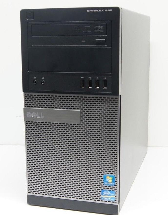

I buy Dell Optiplex 990s (64 bit) off Ebay (or Craigslist) and equip them with Kingston SSD drives. I also use XP for weather stuff.
Sometimes they come with Hdrive and operating system and sometimes they don't. Sometimes they come with Win7.
I've only replaced one power supply and found out later I didn't need to.
I'm using one now and have Kubuntu 18.04 installed on an SSD drive on it.
I use Clonezilla to back up the Hdrive (free)
Greg_M
  • Guest
PS
That's the "Mid Tower" version (desktop).
They usually go for $100 to $150 although the last one I bought was $85 but it did not have a Hdrive/OS.
