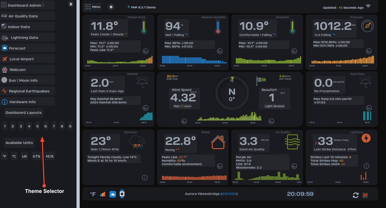

I installed Meteobridge on my Raspberry Pi 4 and use the Weather34 dashboard, love the design, but I've seen a few dashboards with charts in each widget. How do I get to show charts for my dashboard?
Here's an example of how I'd like my Weather34 dashboard to look like - https://singaporeweather.info/weather34-os2-tablet.php
Thank you.

weather34 aurora downloads to get latest master version or simple updates are all now done in the meteobridge admin panel . latest version will give you a total of 9 different themes and an apple watch layout(includes the one your looking for or mentioned) . all themes are selectable via the template menu and in the template admin screen . you can choose which theme you wish to have as default .

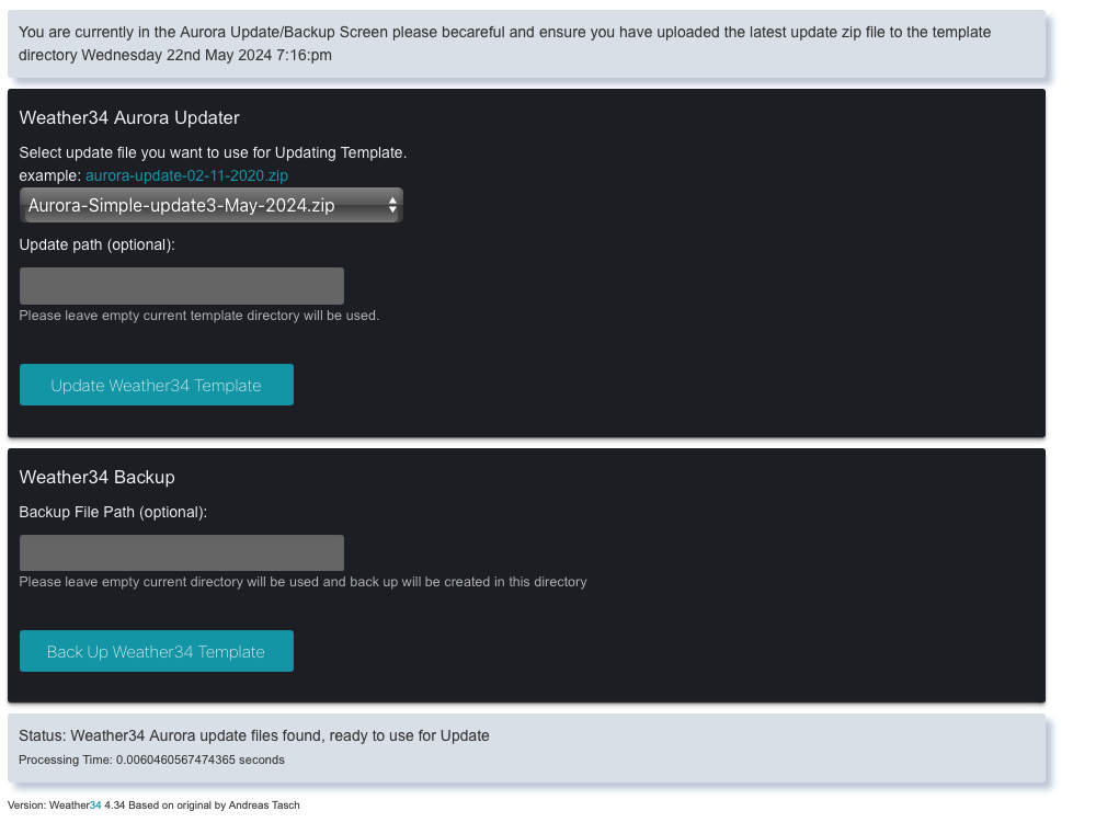

I'm following the below steps and don't see the Simple update file on the Updater page

I checked with Boris and he mentioned that the Aurora Dashboard on meteobridge is a downstripped and non-updatable version. To use the updatable Aurora Template, it has to be hosted on the internet on a server.
Next steps are, I'll try hosting it on my local machine (any tips?) as I'll be using it on an old iPad air locally.
Thank you weather34 for all your assistance.
good evening
internal slim version is only updated as and when Boris requests , i don't have any control over the internal versions i just send along whatever is requested..
