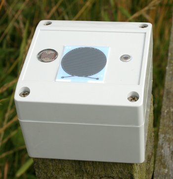

Earlier this year I puchased an Aurora Eurotech Cloud Sensor - http://www.auroraeurotech.com/CloudSensor.php
It has a rain sensor on it - I do not know what it is made from but it is very good at giving you an early warning to intensity. I use it on my site so that the icon changes and the current conditions says that percepitation is being detected if it is small and as the values go up I add that it is raining or bucketing down.
Rain sensor is the large middle item.
I put this graph together from 1 days data - the orange is the values I get back from the Cloud Sensor rain sensor. Not sure what they mean as numbers but 30 is very heavy rain and it is always sitting around 1.5 so I take it that there is rain or precipitation only when it gets to a value of 2.
The black dots at the bottom is when the davis did a bucket tip.
I am sure someone would know what the rain sensor is in the cloud sensor.
Chris
