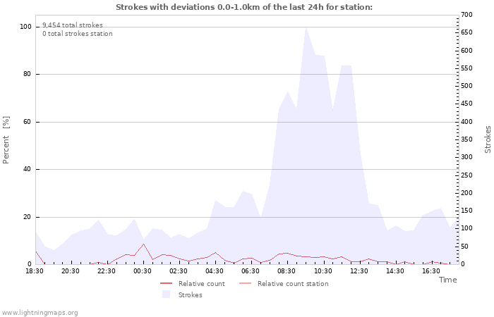

Don
WITHOUT system Reds:
WITH system Reds:
« Last Edit: July 27, 2013, 11:01:09 AM by dfroula »
