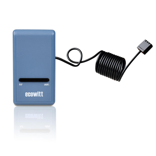

Do you have something like a GW1000 (I guess that it is now "GW1100") device? You might want to confirm compatibility between GW1000 and GW1100 with Ecowitt before ordering.
The WH57 will not work directly with the weatherbridge without some kind of gateway/hub that collects the data from the GW1000 (or subsequent) device.
You will need to add the gateway as an "additional station" in the meteobridge Station page.
Get the gateway working first stand-alone before trying to add it to the meteobridge. Once you select the GW device from the drop-down, (GW1000, but I am going to assume that it will work for the GW1100, unless someone knows something contrary to this), Select TCP/IP abd enter the IP address for the GW1000. This is how mine is set up.
You will be able to add other Ecowitt modules like extra sensors and have them report via meteobridge as well. The WH57 was a later addition, I already had several temperature/humidity sensors working with it previously.
Gateway on Ecowitt: https://shop.ecowitt.com/products/gw1100

Thx Greg. I have the HP2560 console. It receives the lightning sensor- it just doesn’t go to the weatherbridge. Seems overkill to get the GW1100 for this reason only?
Tom
The HP2560 doesn't show up in the available stations list in Meteobridge.
The GW1100 is only $30. This appears to be the only way to get the lightning signal into Meteobridge.
