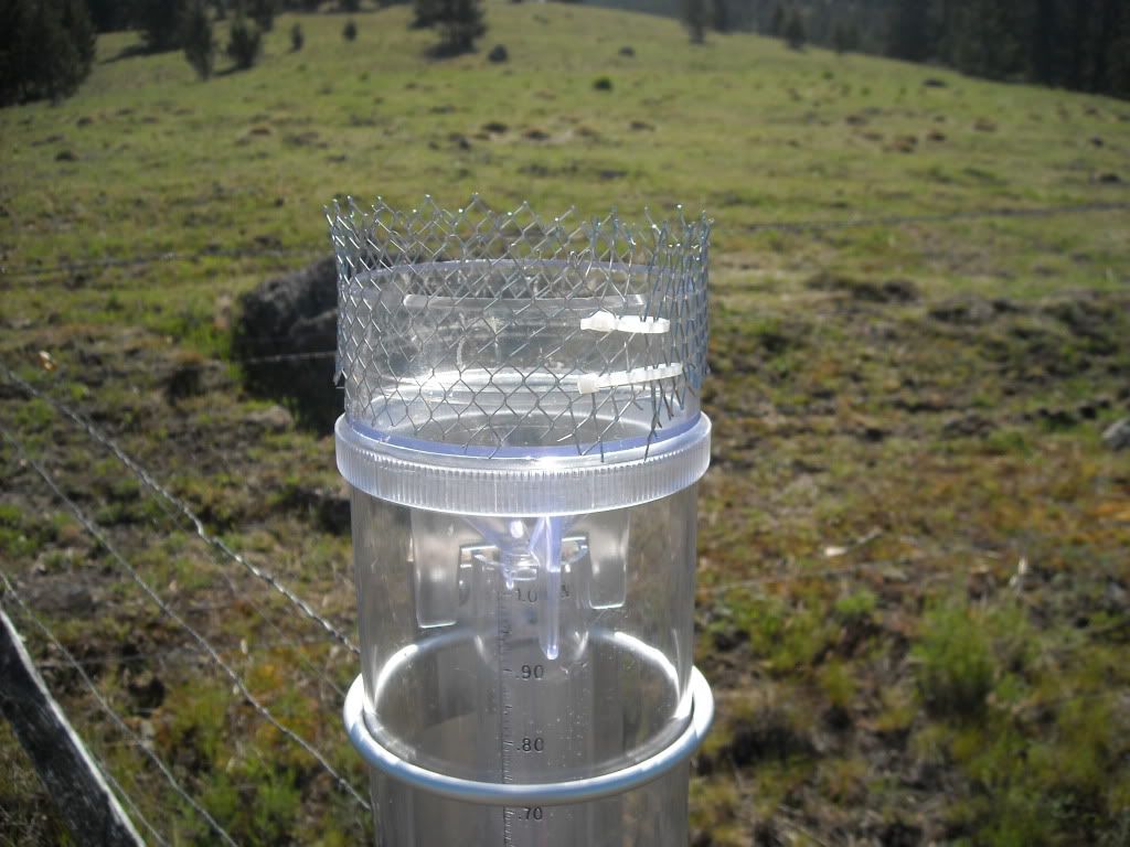

« on: June 10, 2009, 10:36:12 PM »
here is my anti bird setup on both my Davis and Cocorhas.
Items needed-
gutter guard(the stuff you put  on the gutter to keep leaves and junk out) steel mesh type stuff
zip ties
side cutters
time
maybe a set of gloves for people with soft skin lol

« Reply #1 on: June 11, 2009, 02:48:17 AM »
mmm you might find the smaller birds will still perch on the edge unless its razor sharp, however it should keep the larger birds off as they are heavier and it will hurt there feet. From my experience I've found thin long spikes work better as they hit there wings when they try and land and they cant find an edge to sit on.
See how you go.

« Reply #2 on: June 11, 2009, 08:59:22 AM »
So far so good:) they land for about a second then take off:)  so my $3 fix  worked!

« Reply #3 on: June 11, 2009, 09:07:10 AM »
What if they get spiked?
Had not this been better?

« Reply #5 on: June 11, 2009, 11:49:55 AM »
That's more for wind rather than birds, isn't it?

« Reply #6 on: June 11, 2009, 12:38:59 PM »
The WaterLog H-340 came with this debris screen and bird spikes.  Second view shows the screen removed.  It's too wide (7 5/8" diameter) to fit on a Davis.  Never seen signs of birds on the gauge.  The WaterLog is compatible with the Davis.

« Reply #10 on: June 11, 2009, 05:34:29 PM »
Ronco Pigeon Cooker...can cook 8 fully dressed birds at once !!!
Ok all kidding aside...I don't see the purpose of the bend of the spikes and their design.....

« Reply #11 on: June 11, 2009, 05:59:35 PM »
Bird Kabob.
It's just a piece of aluminum stamped in the pattern that gives the spikes.  I found a brand name on the bottom.  "CAT CLAW"

« Reply #12 on: June 11, 2009, 06:31:58 PM »
I wonder about the splatter effect and retention properties from the stamped plates at the bases of these spikes. I recall a different thread talking about the slickness of the funnel allowing all the water to flow inside and this appears to be another obstacle.?.?.?

« Reply #13 on: June 11, 2009, 06:35:55 PM »
I wondered about splatter also.  The gauge is calibrated to be most accurate at high rainfall rates.  At low rain rates, I have to add rain amounts to make this equal to the SRG.  On heavy rains, the gauge is very accurate.  Splatter would occur most at high rain rates.  ???

« Reply #14 on: June 11, 2009, 09:14:12 PM »
Perhaps something that snaps around the rim that you could stick pins into to create a "can't stand here" wall. The thinner the trim the better to minimize the reduction in diameter.  The height of the pins would keep birds from flying and landing inside and spacing between the pins allowing the blown sideways rain in. Nothing leaning over and obstructing the inside either.
