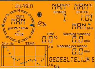

Offline Gert Woerden
  • Posts: 20
Re: Davis 'Live' Console script
« Reply #53 on: December 28, 2013, 10:31:37 AM »
Hi
I have also this script  and it is working ok
I see this have the screen from the Vue that I have made
Some time ago
But there are not so good  !!
I have made new one’s
Now the wind roos is not moving if you push on the light button
And the background from the VP2 is transparent
Also made a new background color
Hope you like ??
Script Vue  http://www.weerstation-woerden.nl/davconvueCW.php
screens below
http://www.weerstation-woerden.nl/download/vp2_console.png
http://www.weerstation-woerden.nl/download/vp2_console_copy.png
http://www.weerstation-woerden.nl/download/vp2_console_lit.png
http://www.weerstation-woerden.nl/download/vue_console.png
http://www.weerstation-woerden.nl/download/vue_console_copy.png
http://www.weerstation-woerden.nl/download/vue_console_lit.png
if you need another background color  ask my and I can made it
greetings  Gert
  • Posts: 20
« Reply #64 on: December 29, 2013, 04:28:45 AM »
Hi to you all
Today I  have find a problem into the script
This is only if you have 2 weather stations  and run weather display two times !!!!
The problem :
If you have the VP2 en VUE script running  you will see that all info are the same
The script looks for the head clientraw.txt and clientrawextra.txt
This is strange because the pads are not the same into davconvp2CW.php  and  davconvueCW.php
I just discover  you most disable 1 line into your second script from your weather station
Go to the davconvueCW.php file ore davconvp2CW.php  and disable the line
if (isset($SITE['clientrawfile'])) {$dataurl = $SITE['clientrawfile'];}  // Use Saratoga setting if available
you can disable it with // and the front
now the script see the pad to the clientrawfile
hope this will help
Greetings  Gert
  • Posts: 20
« Reply #66 on: December 29, 2013, 08:07:09 AM »
hi
yes I have 2 consoles running  Davis Pro2  and the Vue
and I have 2 weather displays running on the wx computer
have also 2 different maps on the server for al the files
I have your script here  Vue  = http://www.weerstation-woerden.nl/davconvueCW.php  still into test
and the Pro2 = http://www.weerstation-woerden.nl/davconvp2CW.php  also into test ( most translate some rules )
the rule : if (isset($SITE['clientrawfile'])) {$dataurl = $SITE['clientrawfile'];}  // Use Saratoga setting if available
this looks for het file clientrawfile  via the ajaxWDwx3.js ore it is another file  I don’t know ??
don’t shoot my if I am wrong ;-)
my settings  Pro2
if ($WXsoftware == 'WD') {
   $dataurl  = './WDL/clientraw.txt';       // for Weather Display 'realtime' data
   $graphurl = './WDL/clientrawextra.txt';  // for Weather Display graph data
My settings Vue
   $dataurl  = './WDL_VUE/clientraw.txt';       // for Weather Display 'realtime' data
   //if (isset($SITE['clientrawfile'])) {$dataurl = $SITE['clientrawfile'];}  // Use Saratoga setting if available
   $graphurl = './WDL_VUE/clientrawextra.txt';  // for Weather Display graph data
If I remove the //  it will read ./WDL/clientraw.txt   and not ./WDL_VUE/clientraw.txt
I have test it
I have remove the file clientraw.txt  for the folder WDL = for the Pro2  on the server
and I see this
And if the file clientraw.txt  is back into the folder it’s read the clientraw.txt  from the Pro2
And if I disable the line  with // before it no problem
For test I have made a new page  1 is without the //
And one is with the // before
See for your self there are not the same
1= http://www.weerstation-woerden.nl/davconvueCW-kopie.php
2= // http://www.weerstation-woerden.nl/davconvueCW.php
sorry I can not good explain my self into Engels
but I hope you know what I mean
greetings  Gert
This an untested use of the scripts.
Do you mean you have two websites, two WDs and two consoles running? If so the paths should be different and therefore there should be no conflicts.
If you are doing something else then a much better description of the setup for each system would be needed.
A good start would be links to the different websites.
But it seems you have found one solution. Perhaps a better one for your special setup would be to hard-code the paths to the essential files in each instance.
I think this is the cause.
While you have two WD delivering into two different paths, the Saratoga scripts are running in the same folder and therefore the Saratoga environment is the same for both, so one will over-ride the other.
So you must manually set the path for one of them. Probably best to manually set them both for your special set up.
« Last Edit: January 04, 2014, 07:31:30 PM by BCJKiwi »
  • Posts: 20
« Reply #73 on: December 29, 2013, 04:37:00 PM »
hi
that’s possible there are into my root
only I can not put the script into a folder on the server
if I do I have a error from whos online   but no problem
it is working ok on this way
and I leave it as it is
ps. into a post of my above you will find some new screens from the console vp2 and Vue
maybe if you are make again a update you can put them in ?
greetings  Gert
While you have two WD delivering into two different paths, the Saratoga scripts are running in the same folder and therefore the Saratoga environment is the same for both as one will over-ride the other.
« Last Edit: December 29, 2013, 05:34:33 PM by Gert Woerden »
