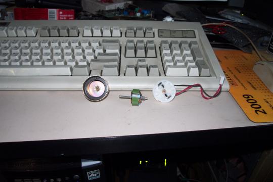

This tech says the fan is just an off the shelf fan, nothing special, ...
I'm not so sure about that, while the motor may be an off the shelf part and the impeller is made by Advanced Air, I believe the housing is a part molded for Davis to their spec.
The one I took apart was the original for my circa 2006 VP2, so the current part could be something different. Does your motor look like this one:
