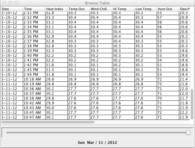

I've just downloaded the data from the data logger at 11:02am local time (3 minutes ago) and here's what I found:
There is clearly no data from 2:44 PM yesterday to 10:18 AM today, yet if you check http://www.wunderground.com/weatherstation/WXDailyHistory.asp?ID=IQLDETON2&day=10&year=2012&month=3 there has clearly been no problems with the console receiving data from the ISS.

So, if I digested that correctly, the Windows computer running Cumulus has no problems with data from the logger, and presumably the logger has a complete archive of the data at the correct intervals.  The "only" problem is with the WeatherLink data on the Mac.
I would first suspect that there's some corruption with the current contents of one of those files.
First suggestion:  Delete the March data file from WeatherLink that is on the Mac, and then re-download the data from the logger.  On a Windows PC, that file would be named 2012-03.wlk  [Yes, it would be wise to backup that file, or just move it to some other location, just in case...]
Then make absolutely certain that the time on your Mac and the time on the console are identical, and download the data.  You should get all of the March data from the logger.  [If WeatherLink asks you if you want to delete the archive data, do not do that, of course]

I MAY have fixed the problem! (The data logger one, still got problems with my humidity)
I noticed that in the Browse section of Weatherlink there was a random recording that was future data by about 2 weeks, don't know how that was possible. So I followed your .wlk file suggestion, except that on Mac the file is called a .ETO file and not a .WLK file
I moved the 2012-03.ETO file to a different location and reopened Weatherlink and downloaded the data, and hello, hello there is new data appearing, it doesn't fill in any of my old gaps unfortunately but is showing the new data that is being recorded by the data logger.
Will have to keep an eye on it over the next few days and make sure that there are no gaps in the data appearing.

Oh No! Something is going very very wrong with my data!!
After watching PrimeTime TV for the last few hours, I've just gone to check my weather station and the temperature and humidity are display --- while the wind speed continues to function normally.
This is NOT GOOD!

THIS IS GETTING ******* RIDICULOUS I'VE FORKED OUT WELL OVER $1000 FOR THIS WEATHER STATION AND ALL I'M GETTING IS PROBLEM AFTER PROBLEM AFTER PROBLEM AFTER PROBLEM. WORKED PERFECTLY FOR 12 MONTHS, THEN IT'S ALL GONE DOWN HILL FROM THERE!
Ventured out in the middle of the night pressed the reset button on the ISS, no problems there. Came back in, reset the console, all working perfectly again, 10 minutes later and every outdoor reading has gone to --- even though the signal strength is perfect, there is a clear line of sight from my station to the ISS and there has been NO problems for the last 13 months and now everything is going wrong all at once.
Plug the station into WeatherLink and surprise surprise Communication error.
Try again, "Archive Memory is empty", can't possibly be.
Try again, "Transfer 210 pages from archive memory to your computer", OK.
Try again, Downloads the data and hello hello there are gaps everywhere AGAIN! This is ridiculous, you'd think for the amount of money you fork out Davis would actually do a good job of these things, guess I was WRONG.
Got a reply from EcoWatch (Australian Davis Dealer), who pretty much said that they cannot believe that there is anything wrong with the weather station unless it is tested by them in a controlled environment and that all they could do was suggest I cleaned the screen and checked for any insects, which I had already done and told them I had already done.

This graph is rather interesting (just captured from your site).
