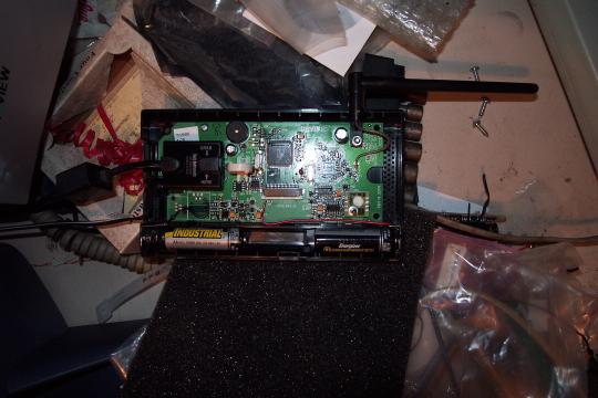

Out of interest next time you open the Envoy case note the position of the Black battery wire where it is soldered to the board. There are three holes, which hole is it soldered in?

Those with Envoy's, open the case and check where the Black batt wire is soldered to the main board, which hole?
Any takers? Might even be an indication why some haven't noticed any changes in the console backup battery for years  Shocked

« Reply #46 on: December 11, 2011, 12:47:56 AM »
OK:
Precious little in your life is yours by right and won without a fight.

C5250, Let me guess, the internal batteries always run down to bacially no volts and the Console Battery Voltage is always consistently higher than around 4.75 volts and always the same?
C5250
Posts: 570
« Reply #48 on: December 12, 2011, 11:20:21 PM »
Fail
Flag
Posts: 609
« Reply #49 on: December 13, 2011, 01:43:59 AM »
Fail
That response is ..... incorrect
Let me fill you in on exactly what that incorrectly (yes that is an incorrectly) wired Envoy is doing. The primary source of power is actually coming from the backup batteries and the backup circuit is powered from the external AC adapter, in affect the primary and backup circuits are switched.
Given time the internal so called backup batteries will definately run totally flat (as they are in affect the primary power source in this case), when flat then the circuit switches over to what it thinks is the backup batteries but which is actually power coming from the AC adapter.
Yes there was a bit of a slip up with some hardware but hey I'm just the messenger and by the sounds of it what you don't know won't hurt you.
