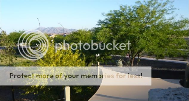

The first photo shows where my CURRENT anemometer is placed. It is a LaCrosse (bad idea) and I will be returning it back to Costco because it is NOT an accurate weather station. I have since bought a Davis VP2.  :grin: Getting back to the location, in the photo you can see that the trees can cause inaccurate readings:

3 - Or should I just mount the anemometer back at the same wood post location I had the LaCrosse anemometer in picture #1?
I would do this before I mounted it to the vent stack.

Just to clarify, the anemometer would be the ONLY thing attached to the PVC pole, nothing else. The rest of the weather station sensors would be located closer to ground level.
I am now leaning towards going back to the original spot (wood post) but mounting the anemometer a little higher. I haven't completely abandoned the roof idea, I still need to think about it.

I think I will go back to the original location and mount it where my LaCrosse was. I will try and mount it a little higher. The roof is too much work and can become a lightening rod invite.
I might not get full wind speed due to some of the trees but if I needed full wind speed, I can check the airport weather station which is just 3 miles down the road. They monitor that stuff.
