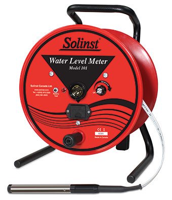

I'm president of, and operate our 58 meter neighborhood mutual water company (for 15 years now). We have 6 hard rock wells. One of them went dry a couple of years ago, so I embarked on a routine of weekly static water level monitoring. It took me a while to make all of the wells probe-able. I got the $900 tape probe stuck a few times. That was not fun.

I use a Solinst 101 Water Level Meter to make the readings.
Now that all the wells are set up for it, it takes only about 20 minutes to read 7 wells, and another 10 to put it in the spreadsheet and generate a new graph.

Thanks for the info, very helpful, I've been thinking of doing this (just for one well) for a while. Many years ago someone told me that they monitored their well by monitoring the pump current so I thought I might log that through the year and see if there is a correlation. How do you sanitize the tape, or more likely I guess your system has chlorination.
