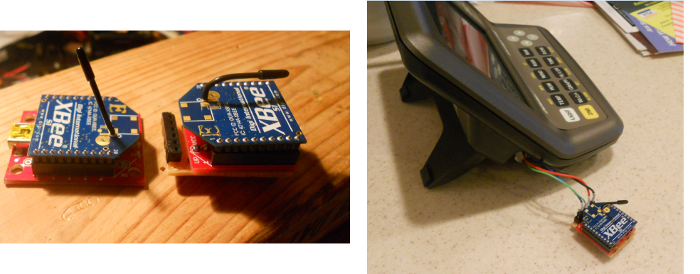

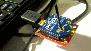

Here's how I did it. First, the easy part.
Buy a USB EXplorer ($25) and a 1mw XBee ($22) from SparkFun, plug it into your destination computer, configure it, and you're halfway done! (You can use a higher power unit of course, but more expensive and higher drain on batteries)
http://www.sparkfun.com/products/8687
http://www.sparkfun.com/products/8665
[You can probably get these slightly cheaper if you shop around, but I just got everything from SF for convenience of the their excellent support]
This is what it will look like when it's running. The red/green status lights are nice, green blinks whenever a record is received wirelessly from the VUE console!

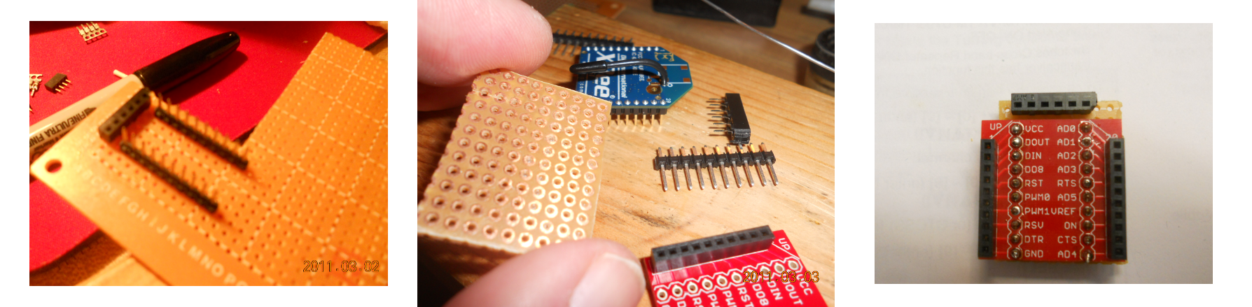

Now the console-side transceiver. Good news: it will be cheaper because we'll build it from inexpensive parts, plus another $22 XBee Modem. But it will of course be more difficult to put together. Don't attempt this unless you have a fine-tipped soldering iron and some building experience.
We'll use the SparkFun XBee breakout board ($3) and a pair of 2mm header sockets ($1 each) which need to be soldered to the breakout board for mounting the XBee transceiver ($22, same as above). Buy an extra header socket, which will be cut up to make the console connector cable (details in previous Phase I posting).
http://www.sparkfun.com/products/8276
http://www.sparkfun.com/products/10030

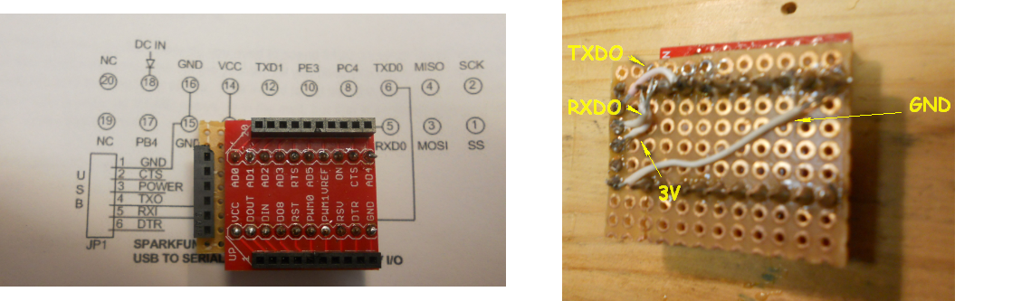

You'll also need some 0.1" spacing PC board (PCB) and a six-pin 0.1" header for the console connector. I had some of these pieces laying around, but you can get them at SparkFun or Radio Shack. Typically you buy oversized pieces and cut them to size. Shouldn't cost more than a few bucks I would guess.
So here's a Radio Shack PCB which I hacked down to size and mounted the XBee breakout board and the 1x6 header socket for the console connector cable

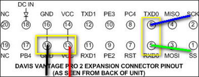

After laying out the PCB you'll need to flip it over and make the connections from the XBee pins to the console header socket
Vcc -> Vcc
Gnd -> GND
Dout -> RXD0
Din <- TXD0
Note that TX _output_ goes to XBee _input_ etc. Most common wiring errors occur here. Also be careful with the soldering iron. It's incredibly easy for solder to "bridge" across pins if you're not careful. Inspect all work with a magnifier before applying power!
Note that the header socket uses the same ordering from DeKay's original design, so that the same connector cable can be used for both the wired and wireless versions (Phase I and Phase II)
[Have I mentioned that without DeKay's intrepid research, none of this stuff we're doing would be possible? We love you, DeKay!]

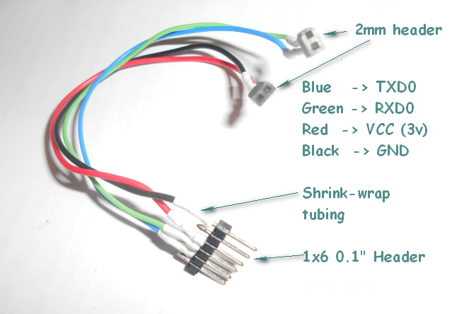

The final hardware step is to build the connector cable, essentially the same cable as constructed in Phase I. If you've done this then all you have to do is connect the red wire to the Vcc 3v connection and you're ready to go. (Don't forget the shrink wrap. I'll guarantee short circuits if you don't use it. Cheap to buy (Radio Shack etc) and easy to apply (hair dryer etc)).

Now you have a pair of transceivers. Plug the USB explorer into your destination computer and the homebrew unit into your console using the console connector.
Enjoy!

I should make it clear that the console cable is a kluge, with those 2mm plugs hacked out of an XBee socket. Difficult to make and install, but it works and avoids having to open the case, as you pointed out.

You're probably wondering why I didn't use 2x10 header receptable with 2mm pitch, instead of the kluge plugs?
Well, they're hard to find (because 2mm is not very popular). Samtec makes them for $2.75 each, but the minimum shipping is $10. So, not wanting to go over my $100 budget (and also being cheap) I decided to make my own. :-)
Digikey carries it too, but they were out of stock, so I didn't want to wait on a back order.
Here's the spec. If anyone can find a good source ("cheap") for these, let us know. It would be much easier to build this plugin using this receptacle:
Samtec Part #:ESQT-110-02-G-D-760
 ("2mm elevated pin header")
http://www.samtec.com/ProductInformation/TechnicalSpecifications/Overview.aspx?series=ESQT

Re: Vantage Vue Console logger pinout
« Reply #42 on: March 08, 2011, 10:32:22 AM »
@lobolobo
> Its labeled correct?
Yes, it's correct, but I should have clarified more that the labels 'RXD0' and TXD0' refer to the _destination_ pins on the 20-pin connector.
So the XBee _output_ goes to the 20-pin _input_ etc.
Vcc -> Vcc
Gnd -> GND
Dout -> RXD0
Din <- TXD0
FYI, my 1-milliwatt wireless XBee's are still running and sending data to APRS/CWOP, from downstairs to upstairs, about 20 feet direct path, through the ceiling. I carried the laptop around the house  and found that the signal starts to fade at about 40 feet and going through several walls. There's a range test function in X-CTU for measuring signal strength etc, but I haven't used it yet. For 10 or 20 feet there doesn't seem to be any range issues. If you have to transmit further than 30 ft or so, through several walls etc, then you may to need use the 60mw transceivers.
Hope that helps,
John/af4ex
« Last Edit: March 08, 2011, 11:19:22 AM by af4ex »

« Reply #45 on: March 08, 2011, 02:12:08 PM »
@lobolobo
> May be a detailed photo sowing the Vantage Vue expansion port with the
> wires conected would be very interesting.
Good idea. Here's DeKay's pinout diagram, showing where the 2mm sockets are plugged in:
Maybe this will help to eliminate some confusion about the wiring.
Muchas gracias!
[Edit: I also inserted this figure into the main writeup above]
« Last Edit: March 08, 2011, 03:13:15 PM by af4ex »
