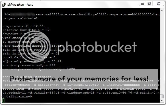

5. Run the files using the following line.  After about 18 seconds, you should start seeing some weather data on your screen.   (Be aware that your account must have "sudo" permission.  Press "ctrl-c" to quit the scripts.
Code: [Select]
./listener | ./parser
Note that this is not yet reporting to wunderground...it's just to show you things are set up OK.  The top part of the screen is the actual data intercepted from the Acurite Bridge, the middle section is human-readable weather data for debug purposes, and the last part is the data as it will be assembled for transmission to wundergroudn.

If all goes well, you should see your station ID and password in the lower portion of your screen showing the data to be sent to wunderground.  If wunderground accepts your data, you'll see a "success" notice at the bottom.
